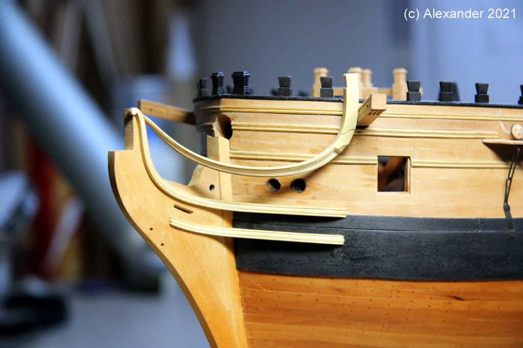

Message  Alex_M Jeu 22 Avr 2021 - 12:43
planksheer continued and timber heads in process.
Les plats-bords continuent et fabrication des appotureaux.
The 20 gun ship Sphinx 1775 at 1/48 - Page 5 Img_0633
The 20 gun ship Sphinx 1775 at 1/48 - Page 5 Img_0634
The 20 gun ship Sphinx 1775 at 1/48 - Page 5 Img_0632
The 20 gun ship Sphinx 1775 at 1/48 - Page 5 Img_0637
The 20 gun ship Sphinx 1775 at 1/48 - Page 5 Img_0636

before I can glue the catblocks on, I have to mount the upper head rails. That's how I started building the Head.
Avant de coller les bossoirs, je dois installer la grande herpe. C'est ainsi que j'ai commencé l'éperon.
The 20 gun ship Sphinx 1775 at 1/48 - Page 5 Img_0815
The scarf joint of upper knee is glued directly on model for right alignment
Le joint du jottereau supérieur est collé en place pour un bon alignement
The 20 gun ship Sphinx 1775 at 1/48 - Page 5 Img_0814
The 20 gun ship Sphinx 1775 at 1/48 - Page 5 Img_0816
The 20 gun ship Sphinx 1775 at 1/48 - Page 5 Img_0817
The 20 gun ship Sphinx 1775 at 1/48 - Page 5 Img_0818
The 20 gun ship Sphinx 1775 at 1/48 - Page 5 Img_0819
The 20 gun ship Sphinx 1775 at 1/48 - Page 5 Img_0822
The 20 gun ship Sphinx 1775 at 1/48 - Page 5 Img_0821
The 20 gun ship Sphinx 1775 at 1/48 - Page 5 Img_0820
